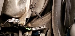

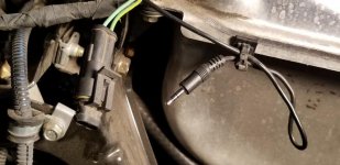

I've been searching through some confusing information on the sound system harness as it applies to connecting a Garmin Zumo 590 (non-BRP kit)... adapters, various cables, splicing, etc. What I found under the side panel at the radio head unit on this 2014 seems too simple to trust, so I thought I should ask the experts. It appears someone at BRP screwed up and actually supplied the 2 needed connectors ( a 3.5mm jack and a 2 pin waterproof connector) stemming from the main radio harness. I'm hoping these are: 1) audio IN jack for the GPS output, and 2) Power (+) and Ground (-) source for the GPS. If so, the harness that came with the 590 is easily usable with just the addition of a 2 pin connector! BTW the 2 pin connector wires on the Spyder are light green with yellow stripe (+)?, and light green with black stripe (-)?
I would appreciate anyone who has experienced this setup on the 2014 RTS to confirm or enlighten me. Pics below...

Where is the GPS harness? the 3.5 would plug into the female 3.5 and the power comes from the connector shown. You may have to order the pins to push into the connector if your GPS cable does not have them installed.
Take a volt meter and plug in the leads. It will tell you which one is Positive and negative . Ex - 12 then reverse the leads and it should be 12

Hey trikermutha, thanks for posting! That's the point to this post... I don't have the large loose connector with a dust cover that people have to tap into with pins and adapter cables, etc. that I'm seeing in posts and videos on this subject. There is one large connector plugged into the head unit and these 2 connectors (in the pics) are factory spliced into it. They are attached to the frame and gas tank, and have dust covers on them, apparently ready to be uncovered and used. This is a pic of the Garmin harness I have. I was testing the polarity when you sent this message

Ahhh good ole BRP, their wiring colors are such a crap-shoot! The green wire with the BLACK stripe is (+). If there's one thing I've learned about Spyders, it is to check every wire with a test light. On my previous RSS, the left and right turn signals were wired with the same color wires, but the polarities were opposite each other!

The Garmin power wires are bare, so I am going to install this (pic) to them and plug it into the BRP connector.I just have to "fix" the polarity, as the black wire on this connector lines up with the (+) wire on the Spyder connector. Color doesn't matter as long as I get the polarity right

As for the power connector all you need are the pins and seals, the connector is already there. It may already have the pins and seals with it?? Take it off and you will know for sure.

He does as it shows in his pictures.
