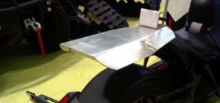

    I am in process of making my own max mount extension. Hopefully it will get done by the end of this week so I can post pictures. What I am making is very similar to Nico 75 post.

    Here is my home made extension.
