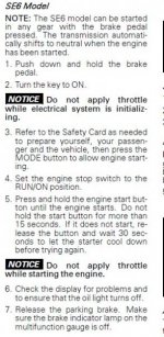

    Do you need hydraulic oil pressure for an SE6 to shift? The way I read it, he only turned the key on, cycled the Kill switch, but didn't actually have it running. It didn’t start until it got to the dealer.

    I am confused as well. It's not possible for a SE model to shift without the engine running. That's normal. Not sure what the problem was.

    So, like an SE5, you need to put your foot on the brake, it starts, then it puts itself into neutral?

    Seems to be a need for additional information and would agree with the fact the shifting will not occur without the egine running. Not that familiar with the newer models..... are you still able to manually shift them into "N" like the earlier models..? Hope that that was the problem.....
    Yes the SE6 is the same as the SE5. Following attached from the 2015 owners manual.

    The brake pedal was pressed for info. Everything was normal but the bike did not start and remained in gear. The computer splash screen came and went away when the MOde button was pressed.

    So the problem was that it would not start and had nothing to do with going into neutral.

    Bottom line it wouldn’t start for me no matter what I did. After it was loaded on the tow and bounced around for an hour it started. I do not know why. The techs will look at it Tuesday
