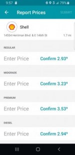

    At least around here it is 60 to 70 cents per gal. more for premium than regular. And that comes to roughly $3 per tank which is the equivalent to a medium cherry dipped cone at Dairy Queen which I tried to do about every tank.
    May 2016
    Noblesville, Indiana
    416
    Premium differential in central Indiana
