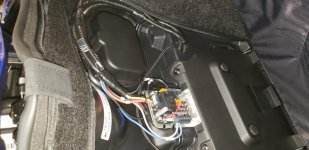

    Here is my 2018 RTL. Looks to me like you need the battery cover. I have mounted my Fuse block to this cover. and routed the wires through the grommet hole.

    The parts diagram for your Spyder, 09-Storage Compartments Front, shows a Battery Cover Ass'Y, #820, PN 705004628, that includes two 3/4" Velcro washers, #820a, PN 293740028. Pic #830, PN 250000767 Torx Truss Screw, Qty 2, are the screws that are needed to secure the Battery Cover. Your picture shows two paint stripes over the holes for the Torx Truss Screws, obviiously painted during assembly, why I don't know, but you definitely need that Battery Cover Ass'Y and the washers and screws installed by the dealer.
