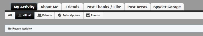

    Maybe I am again having a morning brain fart but I cannot find posts I made in My Profile. When I look at My Activity it says I do not have any recent activity, which is obviously not true as I made this post just yesterday.

    Quote Originally Posted by viiiball View Post
    I click on your name and says view forum posts
    Or go to the left of that copied picture you posted and under your name it says view forum posts too
