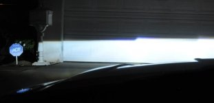

    Normal (projector style lamps) to do this. Look at all the toyota cars with them and they hit a bump and you'd swear they flashed you but that's not the case (rav4 led projector). The beam pattern has such a sharp cutoff that's what causes this (flash symptom).
    https://www.theretrofitsource.com/bl...id-projectors/
    Look how sharp this is - full to black in just 1/2 inch!
    it's the Nature of the Beast, and is considered perfectly normal...
    And with that hard cut line for the lights vertical edge, under braking, sometimes, especially on roads with no street lights, the forward range that illuminates decreases a lot. Even with lights aimed higher than the Can Am spec.
