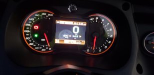

    Latest update on my instrument cluster, Mountain motorsports called me to tell me that the cluster was in and I need to bring in the Spyder. While they had it I added Tricled A arm led lights and a Custom Dynamics high mount 3rd brake light. Got the Spyder back after 2 days they were very busy with all the 4 wheelers coming in for hunting season, all looked good very happy with the Tricled lights as they turn amber when you turn on you turn signal great safety addition. When parking my Spyder in my work shop and having the sun behind on turning off the ignition I was shocked what I saw on the instrument cluster. There were scratches all across the cluster on the inside of the lens and there was moisture in the cluster as it fogged up except for 2 ovals in the middle of each side.
    I called the dealership and sent them photos they were very surprised and admitted that nobody had seen this when they released my Spyder to me. The service advisor told me they would have to work on this to see how they were going to resolve this.
    Dealership told me so as not to get my miles revert back to 0 miles they just replaced the lens on my old cluster but did not see the scratches???? they managed to order another instrument cluster for me and replaced it I now have 0 miles on my 2017 RT and so far it all looks good I will check again today as I got home in the dark .....but on my way home when I put on my turn signal to turn they began hyper flashing. I parked the Spyder for the night and called Tricled for help and their technician was extremely helpful and knew the answer right away ....so this would be helpful to all Spyder riders if this problem comes up. I was told to get the Spyder running and then turn on the emergency flashers and hold down the emergency flasher button for 10 seconds this would reset the blinkers, I did this and they are now flashing normal .....so all ends well. Thanks go out to my Dealership and to Tricled for for helping me finally getting this all resolved.
