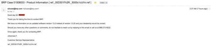

    Is the update really 13.2? I have 12.2 on my bike and my dealer said it was up to date. I send BRP a message asking them directly and they said that 12.2 is the current version...?

    Quote Originally Posted by nethfel View Post
    Attached is a copy of the letter I got from BRP last week. How long ago was this? 13.20 has only been out for 3 or 4 weeks.

    Quote Originally Posted by billybovine View Post
    My response from BRP was yesterday...

    Many got the letter and most dealers will already know about it. If this message is from BRP then they really don’t know what they’re doing. No wonder our messages don’t get answered, because they don’t know the answers. Wow!

    I ended up calling BRP today, really nice person I spoke with said that they didn't show a 13.20 update for BRP Connect. I asked about the warranty bulletin listed earlier in this thread and the person told me that those are associated to machines that need it based on their VIN number. I gave them my VIN and they said mine didn't show any updates? They also mentioned something about an OTA update when my phone is connected to the system - so now I'm just successfully confused about what is really needed lol.
    Bryant, Arkansas
    10,146
    the update 2018-0004 (ver 13.20) is for units with the LED Dash. You don't mention what Spyder (year and Model) that you have so i can't tell you anymore.
    BRP Connect is on the smartphones and updates automatically unless you have it set up differently. As for the 13.20 software update for the 2018’s RT’s and F3’s (excluding the basic models) needs to be done by a Spyder tech at a dealer.
    2021 F3 Ltd , Magna Red
    Jul 2018
    Hohenwald, TN
    27
    And that is what I have - a 2018 Spyder RT (considering I mentioned I had 12.2 on my spyder now I guess I figured it would be understood I had a new unit But BRP claims I don't need an update which makes no sense why some people are getting notifications for 13.2 and BRP seems to have no knowledge about it even based on my VIN.
