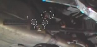

    Adjusting the height after installation is very easy. If you feel if the pedal is too low, and you don't want to do it yourself, you should take it back to the dealer and have them adjust it for you. We have had a few that needed adjusted higher after the initial impression of when they sat on the byke. This picture that I am posting (not very clear has all of the bolts and nuts that you need to take loose. The white line is where they should have cut off excess material when complete.
    The dealer also should have cut the excess of the arms off. Here is the Green Instructions where it is explained in detail where you can achieve an even finer adjustment in section #4. The pedal height can be adjusted in 1/8" increments.

    Just re-read your post and I am trying to understand why the tech did not put on the tether bracket? Much like the safety spring that bracket is designed to make a solid connection between the two points between where the weld in on the BRP bracket. I have not ever heard of one of their welds breaking, but since we are attaching the adapter to their rod I wanted to make sure that if it ever did happen that the tether would make sure and allow you to still use the brakes, even with the weld broken. It is designed to be on there and the tech should have installed it with the rest of the kit. If he had questions as to the installation, I would have been free to have talked to him on the phone. I think you need to contact me and start over. I will take the time to talk you through the entire procedure step by step. With him leaving that part off and not letting you try it first, I am now questioning the install.
    Sadly, some "technicians" are just parts changers. They color well in a familiar picture. However, when given something new to do if they cannot follow instructions, they have no business doing it. If it were me I would not ryde the byke until all the parts were installed correctly. Contact me. Still waiting on that email.

    FWIW - Doc and I exchanged a few PM's about the dealer's installation, and it looks like all is OK. (Just needs a tweak to lower the pedal.)
    FYI - Here's a pic of my installation. Perhaps it'll help others who are considering getting this kit:
    https://www.dropbox.com/s/ys79oh4e1tstwj3/Back.jpg?dl=0
    A BIG THANKS to Doc Humphreys for his quick response to my Questions!
    Bert
