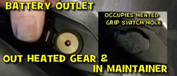

    My F3T came with a SAE pigtail off the battery. I increased the fuse to 15 ohms because the wire is hefty enough. I then put an inlet/outlet in the bag spacer where the passenger heated grips control was supposed to go. Pulled the bag and used a 1/4" coaxial connection between the bag and body so that I can unplug it should I ever need to remove the bag again. Drilled one hole in the bodyand hid all the wiring under the seat coming from the battery directly using the BuRP supplied fused SAE plug in the frunk. I merely changed to a 10 amp fuse in the factory pigtail. This is Warm n Safe's outlet module. >DETAILS CLICK ME<
