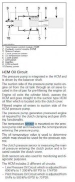

    9,778
    There are oil pressure and temperature sensors in the Hydraulic Control Module, Based on what I see in the parts list the HCM is apparently sold only as a complete unit and the sensors are not removable. That's the only oil temperature sensor I find in the service manual. Here's a blurb about the temp sensor.
