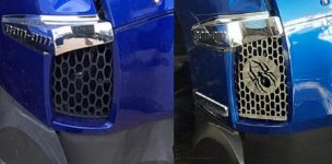

    my grill

    Quote Originally Posted by rtlimited View Post
    my grill
    Where did you get these?
