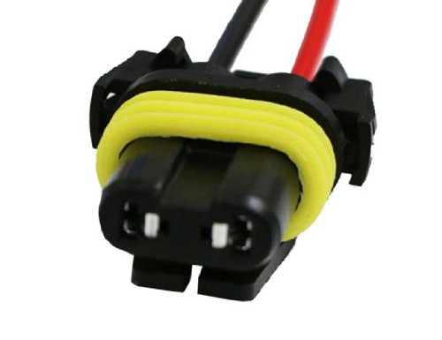

    Would this work, do you think? I could splice it into the short piece of cable with the round connector after I cut it off the old LED bulb...

    It would be the small round 2-pin connector at one end and that barn-shaped headlamp bulb connector on the other end. Kinda like this (top one), only without the regulator in the middle and the female connector like the second pic, not the male;
