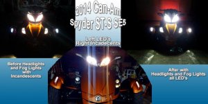

    Default Alright ya'll...she's done...
    Hey all...she's done with her new LED's. The write up is here so readers are not confused: http://www.spyderlovers.com/forums/s...46#post1265146
    But, here's the done deal...

    Quote Originally Posted by bayoumanPIBE View Post
    well glad you got that far Now if you like just go back & add the tricled fog light rings Fyi my current project Thank you Pitbull for the fog lights & Cindy for the rings
