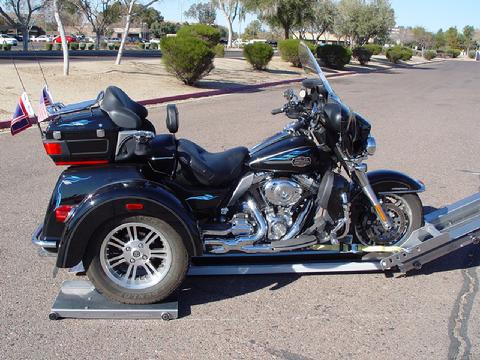

    The only one I know of is by Kendon:
    https://www.kendonusa.com/product/tr...cycle-trailer/

    I did not know Kendon made a fold up for a trike. I have a single rail Kendon I am looking to sell with a spare used it 3 times like new. Bought it last year. Thanks for info!
    Sent from my XT1254 using Tapatalk

    [QUOTE=marty1096;1208204]I did not know Kendon made a fold up for a trike. I have a single rail Kendon I am looking to sell with a spare used it 3 times like new. Bought it last year. Thanks for info!
    The Kenton trike/Spyder hauler is very new, just in the past month or two.
