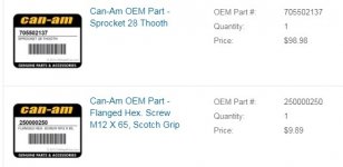

Would love the part number for this new improved front sprocket. Hope this repair holds up for you this time.
I took the Spyder out of the Shop with out any Paper Work , and was told to put some miles on it next week while the Service Mgr. is on Vacation, then we will catch up. He didn’t want me to loose another week of riding while he was on Vacation. I expect to eventually receive the proper Paper Work, and if the Part Number of the Sprocket is on it, I will post it here on this Thread. I think we then would see if its the same old soft Inventory Sprocket using a new Hardened Story. No doubt, The Factory Reps. know my Factory Warrantee expires soon, so another old soft Sprocket from the Inventory Bin should out last my Warrantee. I was VERY surprised to hear my Shaft Splines were still O.K. But if the Shaft is Case Hardened, Heat Treated Steel, and the Sprocket is untreated soft steel, its understandable. But happening twice, and freezing up on the shaft

Part number for sprocket in BRP parts lookup has not changed. No indication of any superseded part number or tech bulletin.
