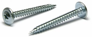

Since I don't load my trailer very often, when I had my GL1800 wing I screwed down roof shingles in the center for traction because I had 4 days of rain coming and had to load it NOW in the rain. Simple trip to Lowes for the shingles and truss screws. Now that I have the Spyder F3, the drive wheel goes up the shingles just fine rain or shine! Sure, they wear out eventually, but they are cheep!
