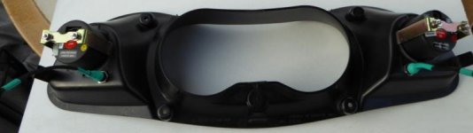

The RT-S comes with coolant temperature and fuel level gauges; the base RT does not. Except as I discovered on this forum if you disconnect the RT-S gauges it goes into base RT display mode with coolant temperature and fuel level on the LCD display.
While the 1330cc I3 seems to be a tough engine, the paddle-shifted SE6 is worrisome as it seems to need proper oil pressure for operation. And the VSS, DPS, etc electronics need their electron pressure (voltage) too. So I bought two health gauges: oil pressure and voltage.
I wanted stepper motor gauges for their needles-not-numbers and 270 degree sweep. SpeedHut and Autometer were kinda outside my price range (I need new front tires) so I bought GlowShift which is a good-enough gauge (eg, 3-wire oil pressure transducer).
GlowShift offers 7 face color choices with the default being Blue markings on a White background.
The gauge function is powered by the Black and Red wires. The gauge face is powered by the Yellow wire. Remembering your color choice is powered by the Orange wire, which must be Always-On. Since I liked the Blue-White default, I connected the Red and Yellow wires to Ignition-On and left the Orange wire disconnected. I used a Ring terminal to connect to the Spyder gauge ground and a Spade terminal to connect to the Spyder gauge power so I didn't have to Posi-Tap any Spyder wires.

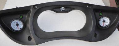

And here's what the dash panel itself looks like.
Them little Green lights? That's another post.

Do the gauges work? Yep. I'll post some videos starting the engine cold and then after it heats up (spoiler alert: lowest oil pressure is 18psi hot 1st gear idle at traffic light -- I'm happy!). And coolant temperature and fuel level are displayed on the LCD as promised.
