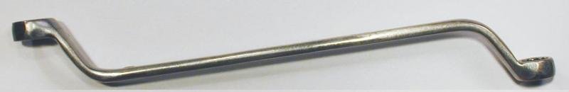

They are called 'Bleeder' Wrench and 'Double Offset' Wrench. They are fairly common. Not hard to find.
https://www.ebay.com/itm/CTA-Brake-B...ss!37743!US!-1
Here is a 6 piece set (12 sizes) for just a few bucks more. Handy to have.
https://www.ebay.com/itm/6-PIECE-MET...wAAOSwzt5baKGW
thanks. I order these kinds of tools.
