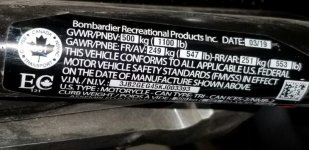

ist easy :
under the ryder-seat is a sticker which shows also when the RYKER was produced .. mine one has a "K" in the VIN code and its built 11/2018 - so the nuts are OK :clap::clap::clap:
(I reach the 10.000 miles now - without any Problems !!)
Chris56, I was just going to post this and you beat me to it! Here is my tag. Built in March 2019 and the VIN ends with 3393.
If you will look at NathanL's reply at the top of the page, the K represents the year ('19).The month is not represented in the VIN.
SORRY- I was wrong- Look under the seat as above. Mine born in November also with 4,300 trouble free miles. Changed my Gear oil and CVT filter at 3,500 miles and Just changed the engine oil with 5w40 Valvoline MST synthetic used in high end foreign cars and diesels as well. Looks like buying early is beneficial this time around.

I will assume that the VIN numbers work the same for Rykers as Spyders. Every model type, with a different trim, factory options, country options and color. Has a different model code number and has its own series of VINs. So yours is 0088. That just means that 87 Rykers that are identical to yours where made before yours.
