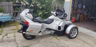

Hi All", I have a rattle noise inside my standard muffler 2010 RT Spyder and I look at it in aboput 30 minutes, however any ideas or similar experiences would be much appreciated,
regards Peter

Hi Mate", this is what I ended up getting done. I got a Walker stainless steel muffler fitted and it sounds better than before, but not to loud. I got cat delete done too. Sorry about the late reply,
Regards Peter
