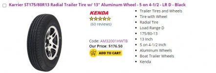

Anyone upgraded the hubs to a 5 bolt 4 1/2 bolt pattern and upgraded to a 13" wheels?
Just wondering..

specifically UltraTow #57225 high speed hub 5 bolt on 4.50 spacing with L44640 inner and outer bearings and comes with 1.25 and 1.50 seals. More options on wheels and tires over 4 bolt.
Follow up. Well, don't.. The axle may work, the tire probably won't. I replaced my 4.80 x 12 tire with a ST145/R12 high speed radial from E-Trailer. Excellent tire, but here is what I had to do. The tire is a little wider than the 4.80 bias ply. After mounting, I noticed a flange on the axle side that was within and almost touching the tire. To close for my standard. ok no problem I just used a grinder and reduced the amount of metal hanging over that edge. Actually like it better being more flush and away from the tire area. Little paint and job done. almost little over 1/4 inch clearance now. Didn't grind into the weld area so it didn't impact structural integrity. ok I thought clearance issue resolved. Install the tire/wheel and a quick spin of the wheel, still a rubbing sound from some where... looking back into the wheel well, dang the shock spring was just slightly rubbing the tire sidewall. Ever so lightly but dang.. Ordered 1/4 wheel spacer as I just need to move wheel out just a little bit to give clearance away from the shock.. Used flat washers to verify, spacing thickness. Moral of the story. anything over a 145 would be to big in tire diameter.
The WHEEL might be an upgrade but the tire certainly won't.
It has that brand name that many of us won't even mention.
