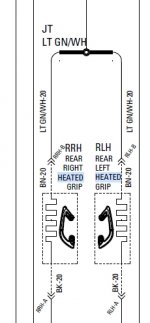

I found the accessory plug under the passenger seat of my f3-t but I also found two identical plugs not attached to anything . I assume it’s for some upgrade I don’t have but would like to know for sure .

It might be the plugs for the heated pass. hand holds.

It could be the connection used to power the outlet in the top trunk that comes on the limited. I'm sure that BRP uses the same wiring harness on all F3 models.
Judgin by the color which looks like Light Green/White
