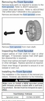

I did not remove the rear tire. Mine is an F3S - so my shock may be different than yours - but I was able to remove the lower shock bolt - jack up the Spyder at the furthest point back on the center frame rail (block the front tires). This allows the rear of the Spyder to lift and the swingarm/tire to stay on the ground. This loosens the belt and allows it to come off the rear sprocket.
I broke the pulley bolt loose BEFORE raising the Spyder and removing the belt so the belt tension held the pulley in place while breaking loose the pulley bolt. I did not take the pulley guard off as the instructions above state for what that's worth. My pulley was not wanting to pull off but wiggling it back and forth and being very patient with little pulls. Once off I used a wire brush drill bit to clean the shaft - then wiped it all down really good with acetone. Don't forget the Moly Paste (or if you follow the older instructions instead the Loctite 660 or 648). I was going to use the locktite but talked myself out of it. I figured the cost of the pulley wasn't that great and I'd rather the pulley fail again and need replaced than the shaft. When I put it all back together I tightened the bolt as much as I could before putting the belt on - but then put the belt on before torquing down the bolt.
Not saying my way is the right way - just saying - this is what I did on mine.
