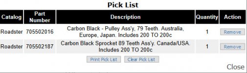

Sorry but they all now have the 79 tooth rear drives, to check this is correct all you have to do is go to this web site.

Hi Chupaca, is the belt for the 89 tooth sprocket N ° 705502157?

The change of the pinion is perhaps the best way to give more acceleration to our vehicle, it is a pity that BRP supplies that 89 teeth only for the northern market AMERICA, I CANNOT UNDERSTAND THE REASON.

By now we have established that BRP has in its spare parts catalog a pinion 89 teeth, so it is no longer necessary to look for those who produce them, the problem is whether it is possible to mount it or not and hear it limping.
