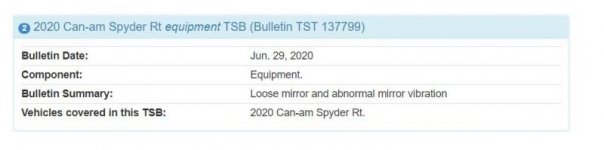

There is a service bulletin out on these mirrors.
BRP has the fix to bolt the mirrors in place and make them rock solid.
My dealer is ordering the parts and will be installing them at no cost when they come in.
