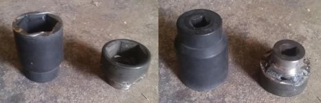

It's been a while since I replace the rear tire on our 2014 RT and I was unable to find my post about that so I'm starting this one just to share the build of a special tool. I built a compression tool for the rear brake caliper when I did the tire change and had intended to do this one after fighting with the too long sockets. Well today, I got through my months of procrastination and modified one of the 36mm sockets slightly to make it a bit easier to control and torque the axle nut. I cut 3/4" off the end of the socket, then cut off and old cheap pawn shop socket with a 1/2" drive to use with the torque wrench. I'm still thinking the long part that is left is much too long and may yet cut some more off of it as the six point configuration extends nearly all the way to the bottom. For now here is the result with my amateur welding included--ugly but strong. :shocked:
