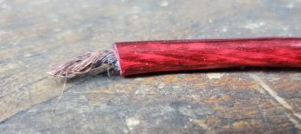

Using a voltage detector probe, I determined the wire providing unswitched power to the PC-8 from the battery probably was the culprit. First, I disconnected the battery end and determined the wire was almost broken at the ring terminal, probably from when I replaced the battery (it's tight in there and the battery connections take a lot of abuse). So I replaced the ring terminal, soldered it in, and wrapped the whole thing with many layers of electrical tape to give it more strength.
The power at the PC-8 was still intermittent so I traced back to where a splice had been put in the line and replaced it. That didn't fix it. So then I examined the inline fuse close to the battery and determined its contact points to be suspicious so I replaced that with a new fuse holder. In so doing I had to splice back in the original cable but when I tried stripping the insulating jacket discovered the copper strands were corroded and breaking off, so I replaced that wire also.
That fixed it finally and now the Stebel puts out the loud two-tone honk it's famous for. See below for pics of the horn wiring and the bad wire.
