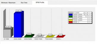

Cruise at higher RPM's with the 900 series engine:
This seems to be a big hurdle for too many owners of the 900 series engine models. Europeans understand high-rev motors – Americans, not so much.
Get over your fear of running the Spyder's Rotax engine at high rpm's. A properly maintained Rotax engine is designed to run at high rpm’s. Do not listen to anyone telling you otherwise. Far too many reliable experts are on the side of this advice.
For proof: The RTS SE5's "Trailer Mode" (with fully loaded trailer) won't let you shift out of first-gear until you hit almost 28 MPH! BRP’s own design engineers let you know the machine can run at higher rpm’s; and force it to do so in “Trailer Mode”. Check this link also, where the owner's Spyder suffered problems by running at low rpm's: http://www.spyderlovers.com/forums/s...ifting-results
