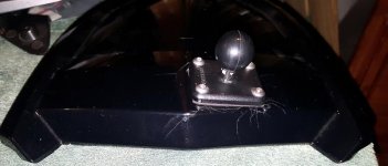

C) DAMAGE NOW - The mount job went smoothly and looked great and nothing cracked. I have not used the GPS on it up to this point and have been riding it for a week or so. So, as I was taking the dash and windshield apart and noticed cracking around the mount.
I used industrial rubber gaskets between the dash plastic and top/bottom mounts with stainless screws and aluminum bottom base and tightened things with just enough torque so damage would not occur. I was wrong.
I can only assume the windshield shaking, hot sun, cool garage and more-than-likely over torquing caused the cracking. I so wish I'd known about the shaking before planning and creating a mount. Not only can I not read the GPS, the dashboard mount caused cracking damage to the upper dashboard console trim. I am NOT going to take a chance to keep the mount job and risk losing, dropping and/or breaking my GPS. I could use it to hold my phone, but over time it will get worse anyway.
Here are some photos of the mount and cracking.
After all of this I've decided to mount the GPS using the RAM mounts on the steering column and re-run the wires. I did not want it there originally because I would have to look down due to my height, but I can make it tall enough I'll be fine.
