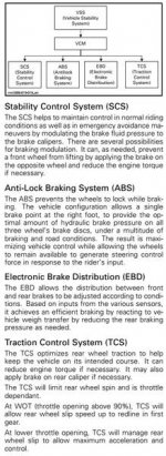

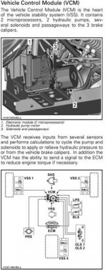

Any Way to disable VSS/Traction control or severely dumb it down?
Have noticed the VSS icon popping up more as I get more confident riding my 23 Rally, especially in ECO OFF mode, less so in Rally mode but still there.
Sometimes I feel it braking/stuttering the wheels in turns, sometimes not. Either way it's annoying me.
Now that I have a Dynojet PV3 custom tune I'm noticing it even more. Was told the Dynojet cannot control any traction control parameters. Can BUDS2 disable it? Or dial it back to a bare minimum? I only have 1300 miles on my bike so I don't think anything is broken sensor wise, but who knows?
Any suggestions?
