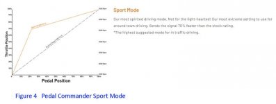

Pedal Commander plugs in between the twist grip and the ECM, and alters the TAS. I don't have a Pedal Commander to measure, but fortunately Pedal Commander has charts on their web site that detail operation (Figure 4).
From these charts, we see that for the same rate of twist, Pedal Commander will send a steeper slope TAS signal to the ECM, but this can and will not cause the butterfly to open any faster than the throttle body slew rate, which is already being achieved without Pedal Commander.
So, while it is technically true that throttle-by-wire exhibits a delay between grip twist and butterfly, and thus throttle response, the delay is very small. Also, the delay, and the maximum speed at which the butterfly can open, is determined by the characteristics of the throttle body motor speed and the mass of the moving parts. No electronics can make it go faster than the throttle body slew rate. We see that the Ryker ECM is not adding any delay in butterfly opening over the physical slew rate of the throttle body, but is operating it as fast as is physically possible. The ECM is not contributing to slow throttle response.
