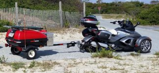

Here are some pictures of the trailer I put together.
I used a Harbor Freight trailer kit. I chose the kit with 12" tires. Took one of the leaf springs out to soften them up a bit. Made the side rails to simulate rain gutters for the roof rack and X-Cargo box that I have had for many years. Fabricated a cooler rack on the tongue and wired a 12v socket under the cooler rack for our 12v cooler. Wanted to use diamond plate for the deck but could not find any at reasonable cost so polyurethane a 3/4" plywood instead. Found a shop that does industrial power coating near me had had the rails and cooler rack done. Using the roof racks makes for some space between the deck and rack rails for camp chairs, tent and the like.
The trailer has made it to the Black Hills, Spyerfest, Chicago area and several Trike-In's over the past year or so. We have towed it thru heat, rain and windy roads without any problems. Looking forward to BRP's Homecoming next year. It will be dragged along.
