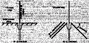

1 Attachment(s)
Sorry if I am teaching you to suck eggs
http://www.spyderlovers.com/forums/a...d=132117&stc=1
The coax length has to be a part of the frequency range, for CB the frequency is approx 11 metres so the coax should be half wave or full wave, so 17 ft equates to 5.182 metres, being half wave. Then you tune the antenna length after using an SWR meter to see what needs adjusting. As you have no real groundplane, they have used a fixed coax length to compensate.
An SWR over 3 will almost certainly blow your output transistor in the amp as the signal will feed back down the coax and straight into the output. Nasty.
Can you line under the bodywork where the antenna is mounted with tin foil and ground it? That will help making a groundplane to reflect the signal and may improve matters. As you probably know, the signal radiates along the whole length of the antenna, not the tip. It needs a groundplane to reflect a "ghost" signal. Therefore, a quarter wave antenna (about 2.5 metres) will have a radio wave leaving the antenna as a 2.5 metre wave and the groundplane will have a similar "ghost" or reflected image making the transmitter look like a half wave in total is leaving. This keeps the output amp happy and efficient. Bundling up 5 metres of coax will not help but is the only way to achieve what you want given the installation on a plastic body.
This is a common problem on boats, even though water is a fabulous groundplane, it is difficult to get it set up properly with a fibreglass hull. I have seen fibreglass cars having their whole roof lined with foil and the antenna mounted mid roof just to try and receive a commercial radio signal in MW.
Sorry if I am teaching you to suck eggs / telling you the bleeding obvious.
