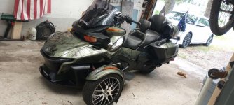

This is our Korea Busan Can-Am team bike. It seems like it's turning into a more interesting bike... haha:clap::clap:

Ah yes, the BMW trademark kidney grille.
That ex-BMW designer must've gotten a new gig at BRP, lol.
