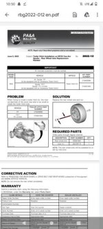

2022 Spyder axle can be replaced under warranty
The dealer will replace axle under warranty.
My dealer needed to see copy of the bulletin.
