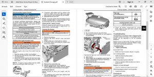

Thanks guys...I have the manual and it doesn't tell how to fully drain the system...I have a pretty good idea how I'm going to do it just thought maybe someone would have another way to do it...thousand different ways to skin a cat you know.
If you do what is in the manual, and if I recall correctly, the radiator then just snaps loose, and you can tip it to drain the radiator.
