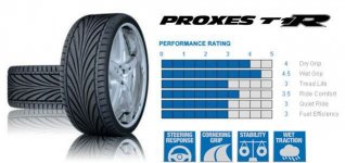

Someone said they run this tire. Guess they run the 55 instead of the 45
if its the same size as stock the computer doesn't know any different.its round and black like he said.those are odd sizes though.and mine has a ton of weight on the left front.makes me think the stock tire is nothing special.just my .02.
