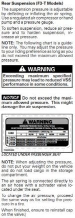

i have the same color bike .i run 10lbs air
Does anyone have a pic where the schrader valve is underneath the seat I can’t find it for nothing. I also have the same color F3t
This is where it is on my 2016F3-L. Bugger....I can’t find the photo....That is obviously the wrong one... those thumbnails are soooo small. have to look later...sorry
Here it is. The valve is top centre , with the silver FOBO cap on it.
