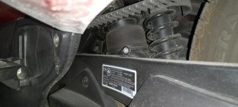

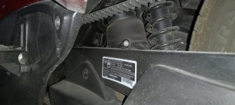

As most of you know by now Doc Humphreys has evaporated from the Spyder scene, and all his accessories have evaporated with him. One of his most beneficial accessories was his Air Ryde Rock Guard to protect the rear suspension air bag from getting rocks under it and wearing holes into the bag. Fortunately, based on my observation and installation of his guard about two years ago I am confident anyone who is somewhat technically proficient can duplicate it.
Two things you need to buy. Go to any good plumbing material retailer and purchase a rubber test cap for a 4" ABS drain, waste, and vent pipe. Toss the hose clamp from it into your "material resource pile for potential future projects"! Drill a 3/8" hole dead center in the end. Buy from a hardware store, or wherever you can, an 8 mm x 80 mm flange head bolt. You probably can use a hex bolt with a washer but I wouldn't guarantee it. You don't want a bolt too long because it goes into the bottom of the air bag and if it's too long I'm guessing you'll destroy the bag. Read Doc's cautions carefully.
Doc's installation instructions are here: https://roadsterrenovations.wordpres...de-rock-guard/. How long they will stay there is anyone's guess. His YouTube videos are all gone. Read his instructions closely, and then review my discussion about installing it here: https://www.spyderlovers.com/forums/...-Armour-Part-1. Decide which route you would rather go, removing the catalytic converter as he instructs, or removing the rear tire like I did.
Following all these instructions should end up with your air bag well protected from gravel bits damaging it.
