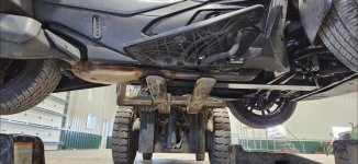

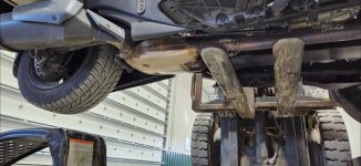

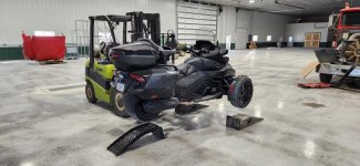

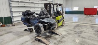

Any reason a forklift can't be used to lift up a Spyder for service?
Has anyone who owns a forklift tried this?
I'm relatively new to the Spyder game. I am ready for a new set of tires on my 2021 RT Limited. After reading several threads on this site (great site by the way), and watching multiple YouTube videos showcasing how to safely lift the entire bike, it has me wondering if my forklift would achieve the same goal? I don't see why it wouldn't, but would like to hear real world experiences. Everything I've read so far, says picking up the bike from the left side would be best.
