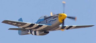

This brings up a subject that has been a question for me for some time. This, and a number of similar air intake kits for other vehicles, are many times touted as a 'Ram Air' systems. Frankly, I do not see how this can be true. Ram air takes advantage of the vehicles speed which creates a pressurized air wave at the front of the vehicle. The faster the rate of speed, the greater the pressure. That is why we put windshields on our motorcycles. To protect us from the effects of this pressure wave of air.
However, a true 'Ram Air' system requires more than just a larger, freer flowing air filter. Ram Air also needs a way to collect this pressurized, higher density, higher velocity air. Typically, this is accomplished with a scoop or collector pointed in the direction of travel. 2 good examples of this are pictured below. The WW2 P-51 used Ram Air to increase air flow over the engine oil cooler. But it is the same principal. Higher density and velocity translates to a higher volume of air delivered to the cylinder, theoretically increasing power output of the engine.
Why 'Theoretically'? Because you have to match the additional air charge with the appropriate amount of fuel for all of this to create an increase in power output.
By the way, my dad took a ride in this exact P-51 fighter. What a smile that put on his face! This particular aircraft is based in Ramona, California (San Diego County). It is a beautiful, Awesome machine!
