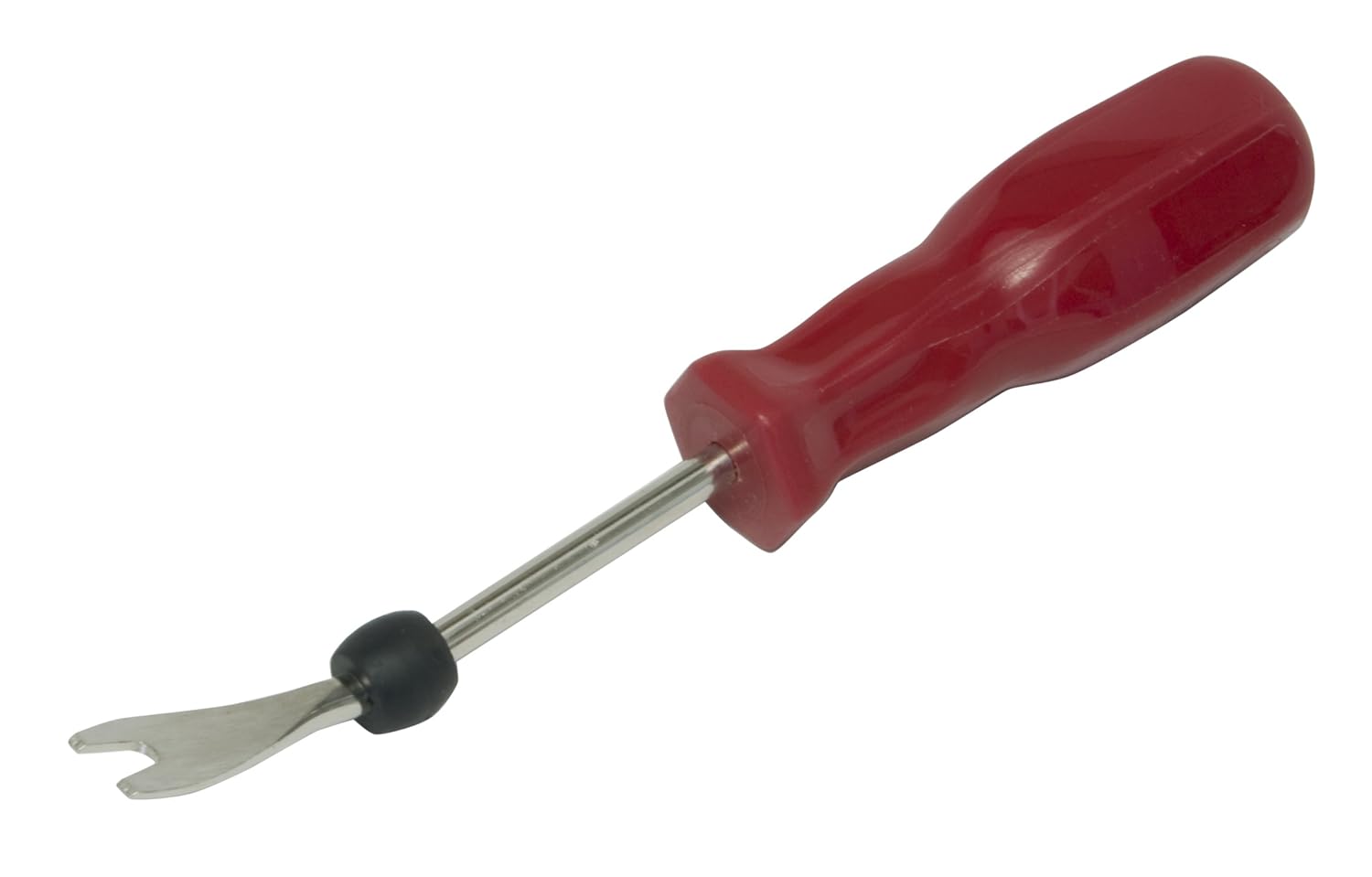

    you can buy the removal 'tool' from AMAZON: https://www.amazon.com/Lisle-35260-P...STIC+PUSH+PINS
