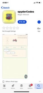

    Sounds useful, but the app shows as $15.99 in the Apple App Store. Is this correct?

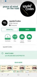

    This shows free to me
    Sorry, just noticed the part about apple

    Interesting. Here is what it looks like in the iOS/Apple App Store...
    Dec 2013
    9,639
    SpyderCodes now costs for Apple phones, but atm is still free for Android phones...
    But we have been told that the next upgrade means it will cost for Android phones too! However, that doesn't take away from the fact that it'll still be Cheap at twice the price! It is a very useful & handy app that can save you a lot of worry & dollars!
