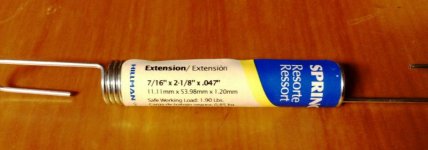

    I have the one from Value Accessories. It is too heavy. I need a different spring. Any body have a suggestion? Thanks Russ

    At least one member figured out how to mount an additional spring to the system.
    (Look up under your bike at the connecting rod, that runs rearward from the pedal...)
    At the rearmost part of that rod: add a thin washer to connection, that you can put a hole in for a spring. Run that spring forward, and hook it to something solid.

    spring 2.jpg From Lowes Hardware Store.
