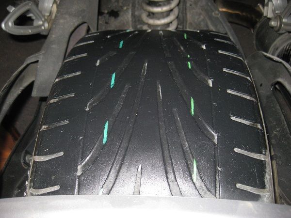

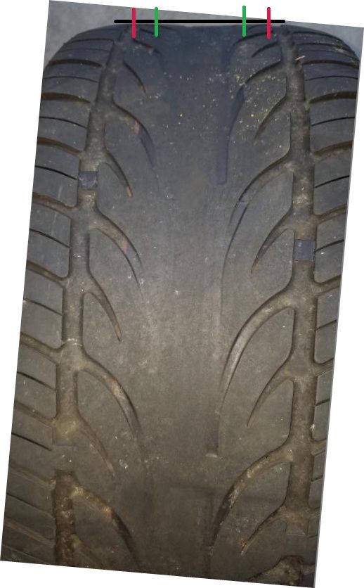

Typical. There is no way to keep a 2 ply tread tire from wearing in the middle. It's a given. Weak tread bands not only allow the tire to bulge in the middle when inflated. Centrifugal force at speed also acts to overwhelm the weak tread area causing a balloon effect. To me, it's a no brainer to go to a well made, less expensive car tire.
A car tire will have a 4 ply tread area. This keeps the tread flat against the road. When riding on the Kenda at speed you're only getting maybe 3" - 4" of contact. The rest of your tire is spinning in the breeze. Not a comforting thought if you have to make an emergency stop.
As you can see, I got my monies worth out of this Toyo Proxes TR1 tire (Left). Notice how much tread I put on the pavement compared to the Kenda (Right). The Toyo maintains a flatter tread area so you get nearly 100% contact with the pavement. As you can see, not so with the Kenda. The Red area is how much contact you have with the pavement at lower speeds. The Green is all you have at freeway speeds.
I know there are Kenda fans. But I wonder if they understand the full story.
