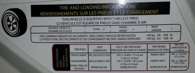

I filed a complaint with BRP. While getting the VIN # I noticed under the frunk a tag that says "MAX riders 2" and "MAX weight 438lbs". YET..BRP says shock is only rated for 240lbs!!! I would say that is FALSE information from BRP. Anyone else agree with me?

Here is my sticker from the 2015 F3-S

So the default shock is only rated for 240lbs. They give you options but at YOUR COST! The sticker on the F3 and the owners manual clearly state max weight of 438lbs. No where does it state you have to get larger shock to reach the max weight. Waiting for their response back.

Considering the answers we received from the warranty and the service departments, and bearing in mind that the total weight indicated on page 73 of your operator's manual is 199kg (438lbs) which includes the operator, passenger, cargo,and added accessories. The weight restriction on a part is not considered a manufacturer's defect; therefore, BRP will be unable to comply with your request for assistance, in accordance with the written limitations stipulated in your Operator's Guide. This is BRP's final decision on the matter.
