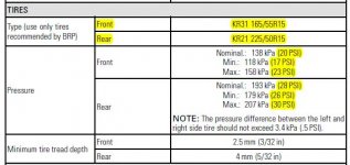

    is a 215/60r15 tire the right size for the rear of a 2014Rt? Thanks I noticed I now have a 225/60r15 on it. which one is the proper size?

    From pg 164 of your owner's manual.

    I'm running a 215/60/15 for 19,000 miles with no problems.

    225/50-15 is the correct tire size...
    HOWEVER: The 215/60-15 is a viable option. In fact: if you have the factory-mounted GPS, it'll probably make your speedometer agree more closely with your GPS, when it comes to your actual speed.
