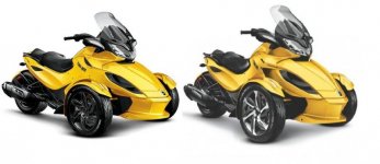

    Here's a picture of a 2013, and a 2014 ST...
    The hood scoops on the 2014 are a direct bolt-on for the RS...
